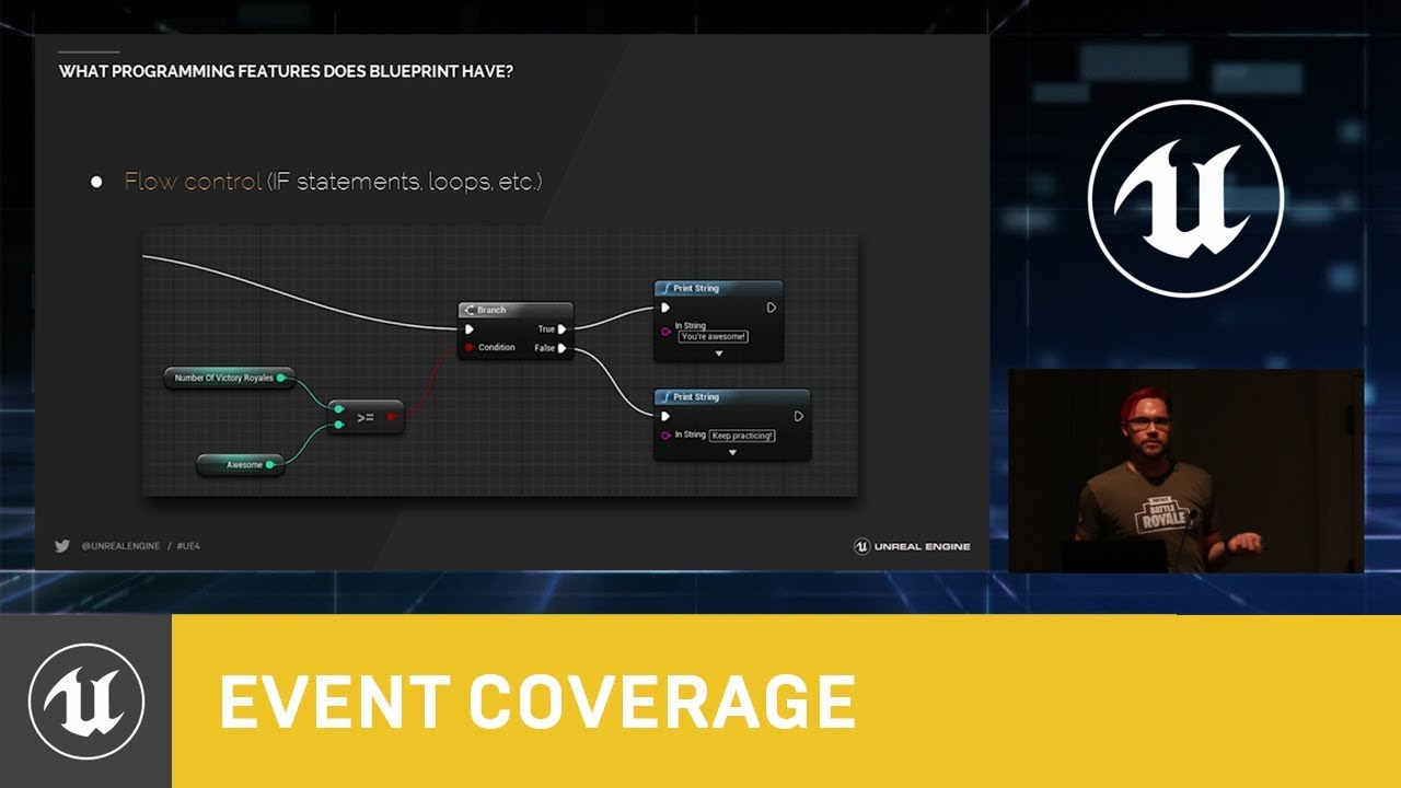

In fact this video: https://www.youtube.com/watch?v=UAF1cx1Nrok well this is exactly what I would like to find. He explains that you could teach all these basic coding concepts with unreal, but doesn’t actually do that. I get that is not the point of the video, but man it sure is the info my artist brain wants to get at.

I think I am looking for something in between. I don’t have a specific problem I want to solve. The documentation on Unreal.com seems to go very deep on features but not really a higher level, “here is how it all fits together” type of explanation.
Really if the concept described in this video was actually a course I could take I think THAT would be exactly what I am looking for.
He states in one of his slides “Once the students are proficient with Blueprint they understand the core concepts of programming”
But there is no place I have found that gives these core concepts in a holistic way first so you can recognize them in BP and thus then become proficient with Blueprint :slight_smile:
