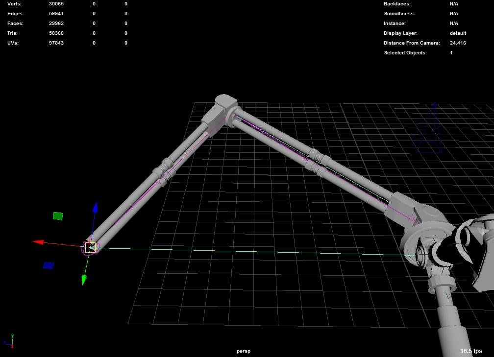

Dear Tech Artist Community,
I’m trying to create an IK control for a robot arm that has two motors for each joint: One for the twisting and one for the bending.
So I created the chain with joints for each motor and restricted the “Degree of Freedom” to what they are allowed to do.
The regular Rotate Plane Solver fails.
The Multi Chain IK solver does a good job. Only with the not really acceptable limitation that doing something like a pole vector constraint type control for the orientation of the elbow doesn’t seem possible.
So the question is: Is there a way to use the ikMC Solver + a pole vector type control? Or… a completely different way of rigging this?
Thanks!

This doesn’t really look like it moves the way an IK handle moves. The ‘shoulder’ should be a ball and socket. Twin hinges aren’t a ball and socket. I’m imagining trying to twist that ‘elbow’ joint upward with a pole vector control, and the shoulder doesn’t bend that way. To work like an IK, you’d have to keep that shoulder bending joint (bigger one) in plane with the forearm at all times (it’s not in the pic), and what I’m presuming is the twist in the elbow (smaller joint) would also have to always keep the forearm in line with the upper arm. I think you could solve a lot by removing the twist from the elbow, and only keeping the bend motor there. I think you could then get away with the twin motors in the shoulder as a pseudo ball and socket.

You sent me on the right path and I found a compromise solution: I kept all the hinges, but added an additional ball joint at the root. Now even the rotate plane solver works and I can add a pole vector. The robot wasn’t supposed to have ball joints, but visually it still has a similar appeal now.
