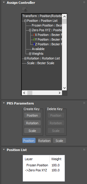

Pretty new to 3ds max scripting coming from Maya/python. I’m trying to figure out how to script setting keys on a different position controller called ‘Zero_Pos_XYZ’. I have some objects who have their positions frozen through a position list so their zero’d out location is not 0 in the world (like Freeze Transforms in Maya). When I animate them through a script, it still affects them via their actual world position. Here’s the testing script I’ve been playing around with:

I imagine the issue is something with the node.Position needing to be set to the Zero_Pos_XYZ controller but nothing I’ve tried seems to work. Thanks in advance for any help.
