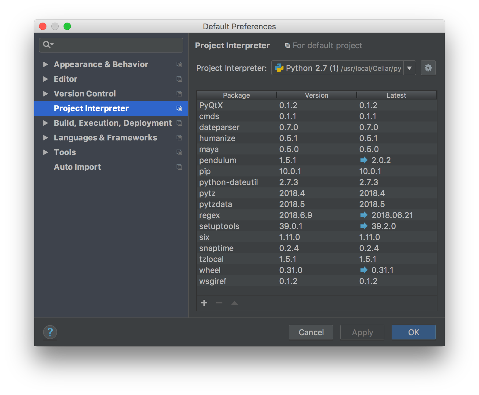

#5
You need to add the Qt library package to your interpreter in the preferences. So you will have to PIP install PySide, PySide2, PyQt4, PyQt5 or whichever Qt library you are using because PySide won’t be linked to the modified Qt libraries that Maya Python uses.
