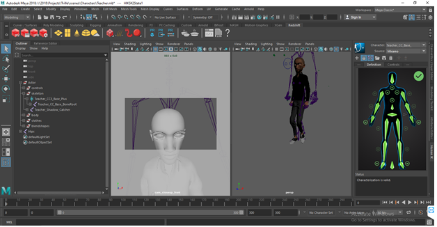

I have this mixamo fbx file characterized and ready to go. When I manually bake the animation to the character’s control rig everything works fine. But when I try to do it via a short script with python it does not seem to work. Anybody knows what I am doing wrong. I am using maya 2018

Why is the skeleton 2x the size of the character? That usually produces a bad result.
It seems that the ctrl_list is an empty list. Try adding the path to the top most joint to that list and see if that works.
The hi=‘below’ expects a top node.
